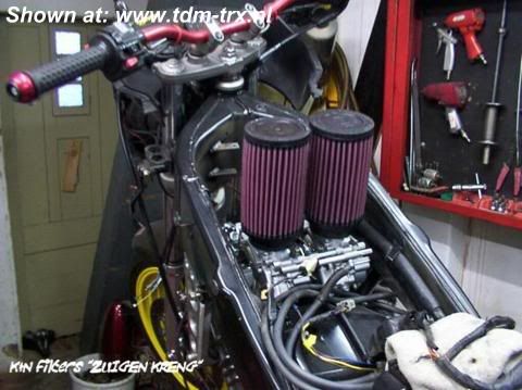

CULater, what's the dimensions of those K&Ns in the photo?
When I had FCR41s on the Guzzi, I had to use K&N "pancake" style filters (as seen on '60s Triumphs etc) because of lack of space with the frame rails - from memory the ID of the filter flange was 52mm.

My filters are the RD-0620 from K&N
So flange dia is 57 mm
I have Mikuni's, don't know if there's a difference between Mikuni en Keihin sizes ?
http://www.knfilters.com/search/product ... od=RD-0620

Nope, we measured the dimensions first, so it clears the fueltank by a few mm's.wicky wrote:CU did you have to modify the fuel tank to fit over these large filters ???? WiCk
But, to my knowledge, on a TRX their is less space under the tank than on a TDM

well they look like something an Iraqi Kurd would use on their bike to mortar bomb a settlement
