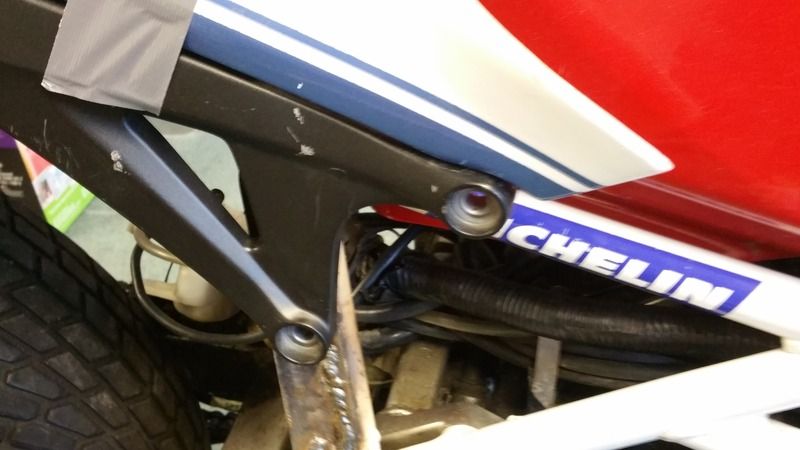

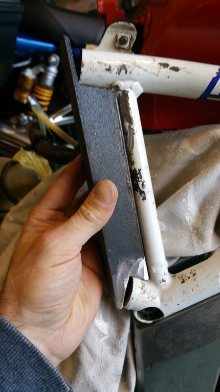

back end chopped off:
fabricated a more sturdy mounting point for the rear subframe:
Welded in place and subframe pushed over:
Needs a little dressing up once the bike is stripped down but its strong enough for now.
holes drilled and the lower subframe mounts mocked up:

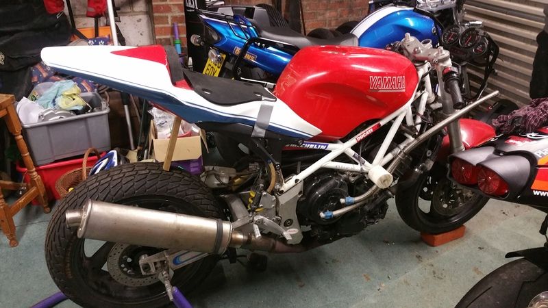

its a 2012 Honda fireblade rear end. it came with my fireblade track bike and I nearly binned it, as it was one of those things that would sit and take up space for 6 year then eventually get chucked. thankfully my dad gets profit from it.
We have it roughly in place. its much taller than the stock trx seat unit, but it give a more modern look and ergonomics.
