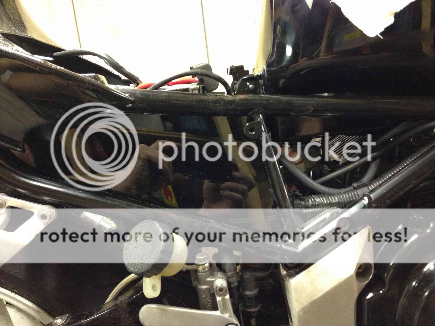

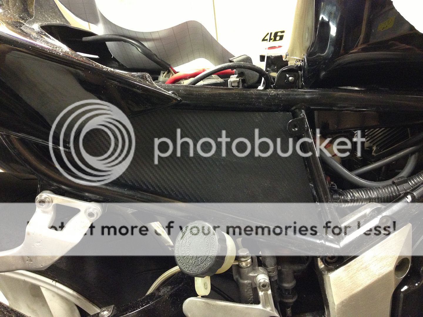

Post by Yoozy » Tue Aug 06, 2013 10:53 pm
Got a load of wiring and plumbing to hide behind the battery and its bothering me. I knocked these panels up but can't make me mind up. Opinions please,,
1 plain shiney
2 trial fit carbony wrap
Them can hangers are coming off btw :shock:

Re: Trx with an Rsv Mille back end fettle !
Post by coxylaad » Wed Aug 07, 2013 11:24 am
I did this sort of thing:
obviously my back end is completely different to yours but its a similar type of affair.
I would pull them out a bit so they are not recessed on the inside of the tubes.
Post by schmiffee » Wed Aug 07, 2013 2:20 pm
coxylaad wrote:I would pull them out a bit so they are not recessed on the inside of the tubes.
Oh see, I would prefer them where they are on the inside...let a little more of the frame SHINE!! 8)
Post by bubbaad » Wed Aug 07, 2013 7:06 pm
Yeah.....Frame showing for me but not the shiny black. Maybe something that contrasts with the frame a little. Bike's coming along well mate, looking forward to seeing it finished 8)
Post by Yoozy » Wed Aug 07, 2013 7:23 pm
Carbon it is boys. Headlight, winkers and horn all nailed on and wired up tonight. Just gotta get some clocks on and we're off :D

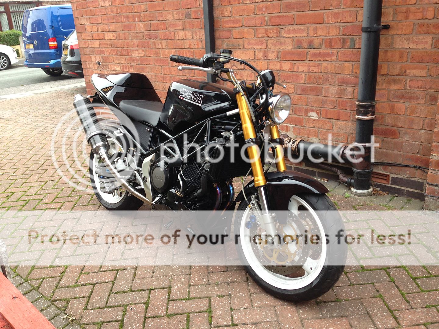

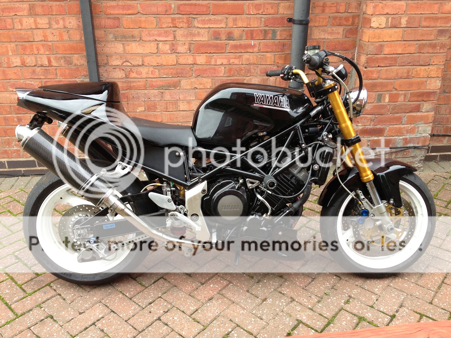

Post by Yoozy » Sat Aug 10, 2013 9:33 pm
Been down our road on it, nothing fell off or blew up :lol: Steering needs whipping up a tad, other than that :D Not sure ont theadleet though. I'll wash it and take a few more piccies tomorrow.
Got a couple of little jobs to do yet,,and I seriously pissed off with the headers :x
Post by sadmansteve » Sun Aug 11, 2013 11:44 am
You need to sort those throttle cables! how long are they? Invert the cable housing or use an R6 2CO housing and have the cables exit under the handle bar, it will look neater than them stuck up in the air. By doing this they also take a shorter route and you don't need extended cables.
Post by Yoozy » Sun Aug 11, 2013 2:09 pm
Eye, that's on the list along with some black brake lines. Other than that it's ok then :lol:
