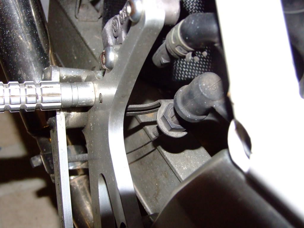

Post by slow codger » Thu Feb 03, 2011 9:28 pm
Bracket is held on by the hanger, with short bolt into that, spring is held onto a long bolt into the brake pedal. Hope you can see from the above pics, and that this may help you.

Post by NWS870R » Sat Feb 05, 2011 9:31 pm
You need an M8 female rose joint (see the picture Harris sent you) you should be able to pick one up for about £3 :D The rose joint will bridge the gap left after removing the clevice arrangement from your master cylinder
