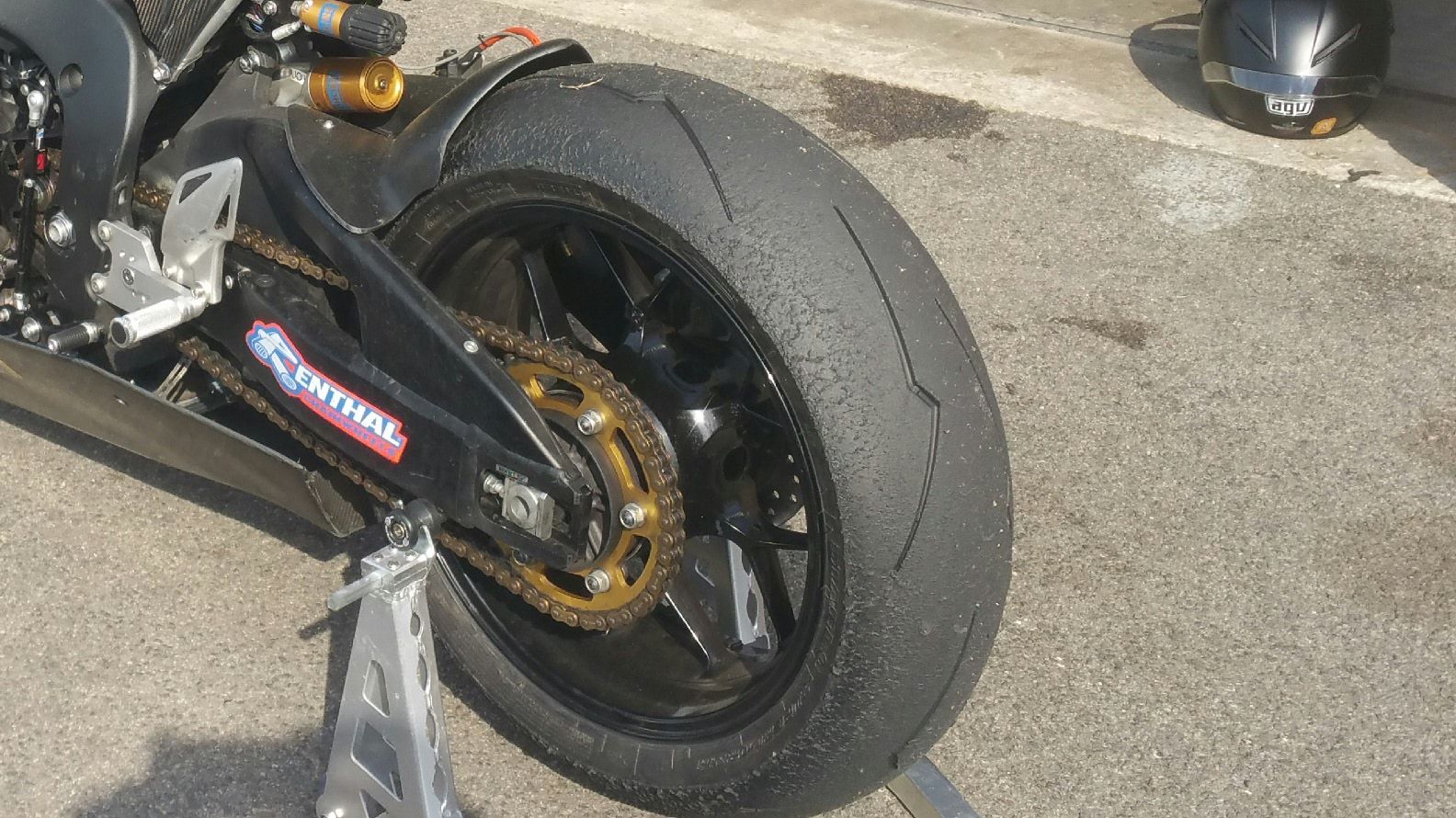

Post by coxylaad » Thu Sep 08, 2016 11:36 am
Tyre wear - discuss
Since I have moved to a big bike I just cant get the tyre to run clean. The blade minced a tyre in one day. that's going to get expensive!
the tyre is not chewing so much as wiping the surface off aka cold tear. but with cold tear you reduce the pressures, I have knocked them right down to 23psi cold (27 hot).
I am struggling to make any progress with it.
any people with good tyre knowledge on here?

Post by dandywarhol » Thu Sep 08, 2016 12:07 pm
I find this pretty accurate - I don't think you're cold tearing - you're 140 bhp through a small area tearing - go get a 660 :lol:

Post by coxylaad » Thu Sep 08, 2016 12:27 pm
its 165 at the back wheel actually Al but your point still holds :lol:
I have just seen a few other litre bikes and their tyres are very smooth with no debris on them.
