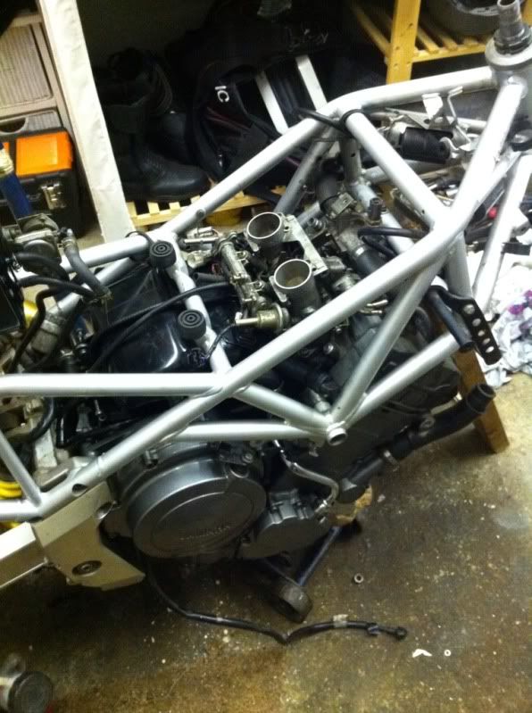

Couple of bits of progress today:
Took the plunge and chopped the back end off.
also pretty much finished the modifications to the TDM900 oil tank. Wasnt too bad really.
Need to fit a breather then get the lot powder coated.
Posts: 1211
Re: The TRX900 Project kicks off
Post by coxylaad » Thu Feb 23, 2012 12:38 am
little bit more progress tonight. The TDM900 oil tank is definitely a goer.
Its sat nicely in there fully functioning with all pipes and sensors, just needs taking back out and tidying up and painted now. I will do that once I have completed my trial build.
pic:
