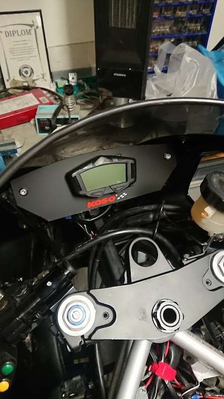

Instrument cluster
Koso DB-03R replacing stock clocks.
Finally, something's going on. Replacing stock instruments, this was on the list from the very beginning but not been a prio wanting to ride the bike instead. Beeing 2020 that's not happening very much, and when days are booked weather puts a pin in the wheel so to speak. So had to do SOMETHING.
Sorted throu cables and identified the one's I needed today and hooked the Koso DB-03 up temporarily to see if I managed to find the right ones or if it was going to blow in my face.
So far so good apparently. :roll:
Going to use the speedo, tacho, shift light, water temp and neutral light functions. Being a simple very analog track bike there's not much more sensors available or functions needed. Also 500 grams lighter than stock so theoretical weight just dropped below 180 kg. Need to check this on a scale any day.
Cables
Instrument need a constant +12V (red): Tap into red before ignition lock, there's a two-cable connector same place as the others under the tank.
Instrument ground (black): Several available from back of stock clocks. Pick one, marked "B" and attach.
Instrument power on (brown): Turns on instrument with ignition. Same as striped red to stock, there are two available from either tacho or temp. Use either one.
Instrument tacho (brown with connector): Connect to cable not red or black from back of stock tacho. Settings in Koso needs to be adapted. If you have Ignitech, adjusting in unit can help.
Instrument neutral (white): Just connect to light blue to stock neutral light.
Instrument temp (2-wire connector): Not sorted yet, but probably easiest just to replace the stock sensor in cooling system and use Koso connectors.
Flash lights, high beam etc: Just tap in to colored cable to corresponding stock lamp. Like yellow for High beam.

So this was crap for track use. Get an RX-02 instead. DB-03 only usable for normal road use where time is slower.

You mean the dash? What's wrong with it?
jpe70
Posts: 221
Joined: Tue Dec 27, 2016 3:03 pm
Location: At The Twin Workshop
Re: jpe's Bumble bee - The collected mods
Post by jpe70 » Sat Aug 08, 2020 11:56 am
Tarwetijger wrote:
jpe70 wrote:So this was crap for track use. Get an RX-02 instead. DB-03 only usable for normal road use where time is slower.
:evil:
Nothing really wrong I suppose, just some issues. LED display is not the fastest so updates are kinda not always keeping up, did a test ride on the street and had no issues with it. Numbers on the rev counter are way too small to be easily spotted by a glance on track. Not a chance. Small for road use too, but matters less and there's usually more time for looking at it. I use 5 magnets to get higher frequency on speedo, but it still lags on track. Even on the TRX. Also seems there's a significant measurement error since I've checked circumference twice and meter is still not displaying correct speeds.
Gear shift light works, it's the only thing I actually can and do use on the track. It's set yellow for 8000 rpm and red for 8500 rpm, very small difference on those two in color so I shift when yellow comes on. Clearly visible in my face actually. :lol: If I shift late on red it sometimes keep blinking when clutch slips a little or rpm doesn't fall quick enough. Good thing I know the engine enough so I know not to shift again right away. :roll:
