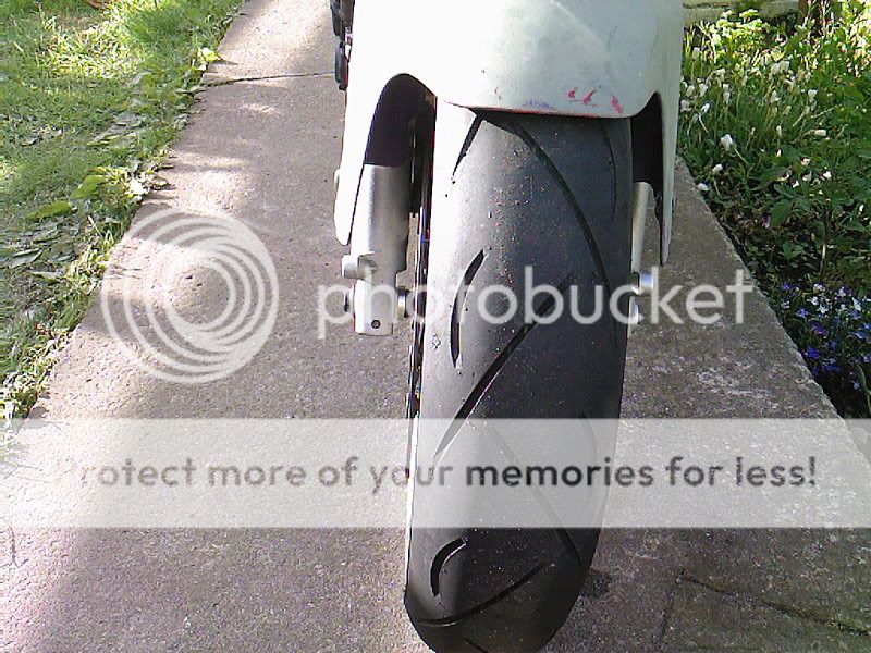

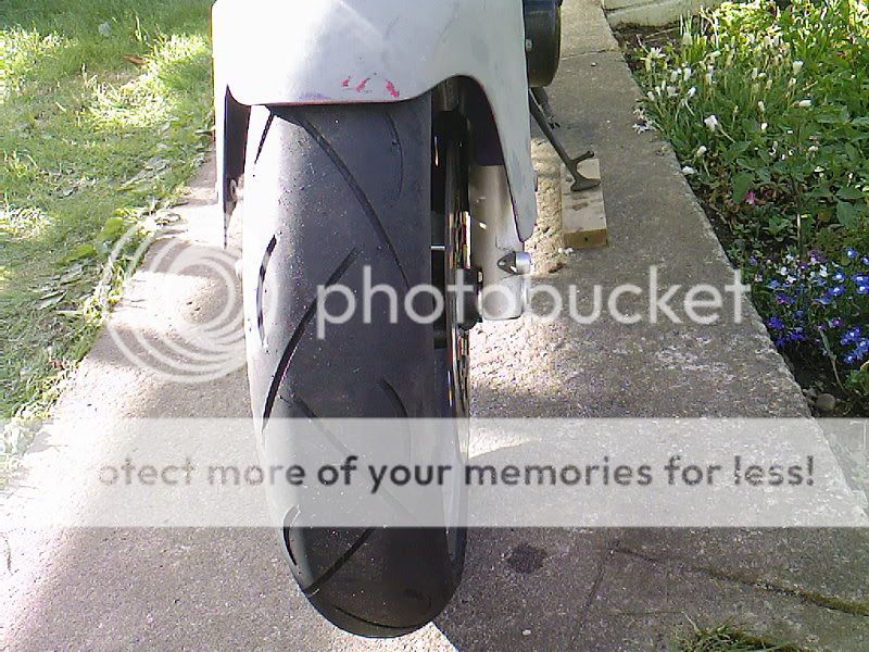

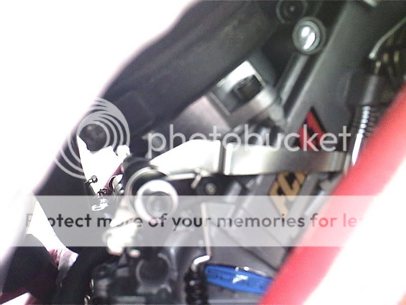

Kayla wrote:Here's a few pics of the Thundercat forks fitted to my bike. It was pretty straightforward and the spacers were perfect (thanks Greg!).
'Scuse the mess![]()
Mmm... adjusters
YZF750 mudguard looks a little Bodgitt & Scarper at the mo- nothing a few minutes with a heat gun won't sort but it'll do for now![]()
You should be able to see the new spacers between the speedo drive and spacer and fork legs. Can't get the last 10mm of the front scrubbed in
Gratuitous FCR shot![]()
Polishing nerds- Yes, my bike is scruffy but it works and it's great.
