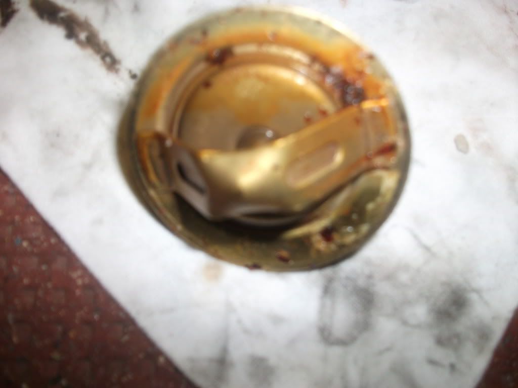

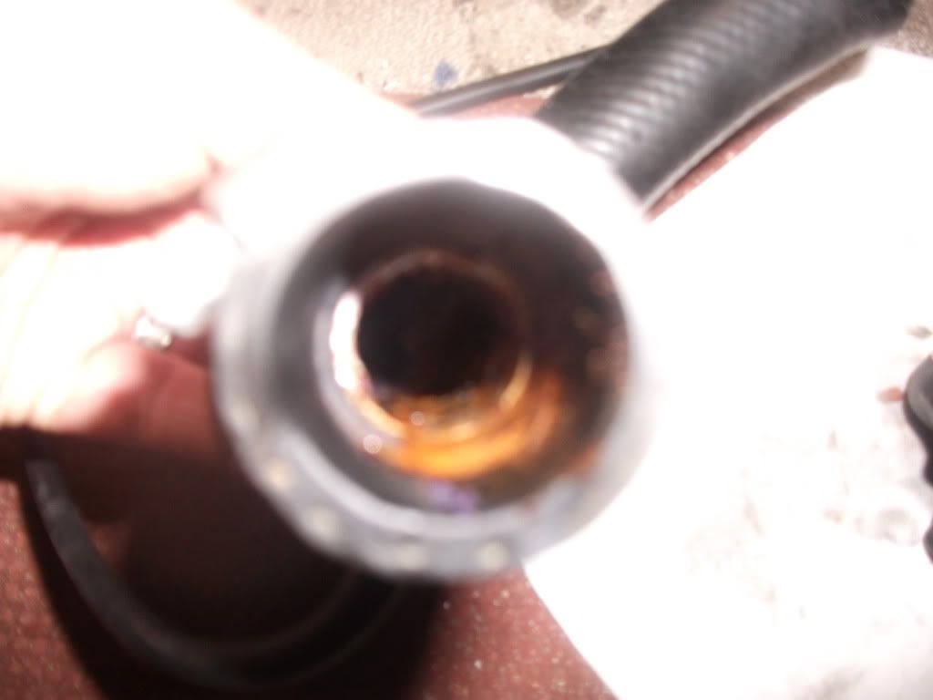

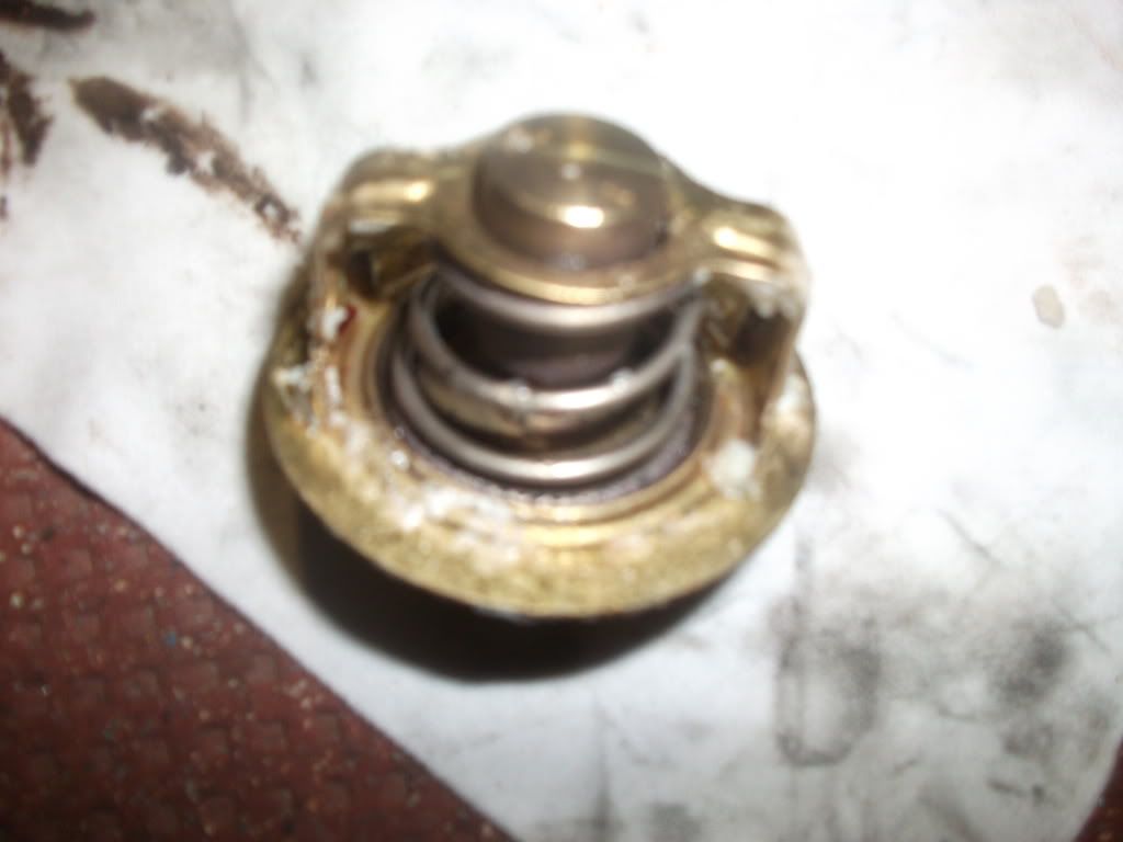

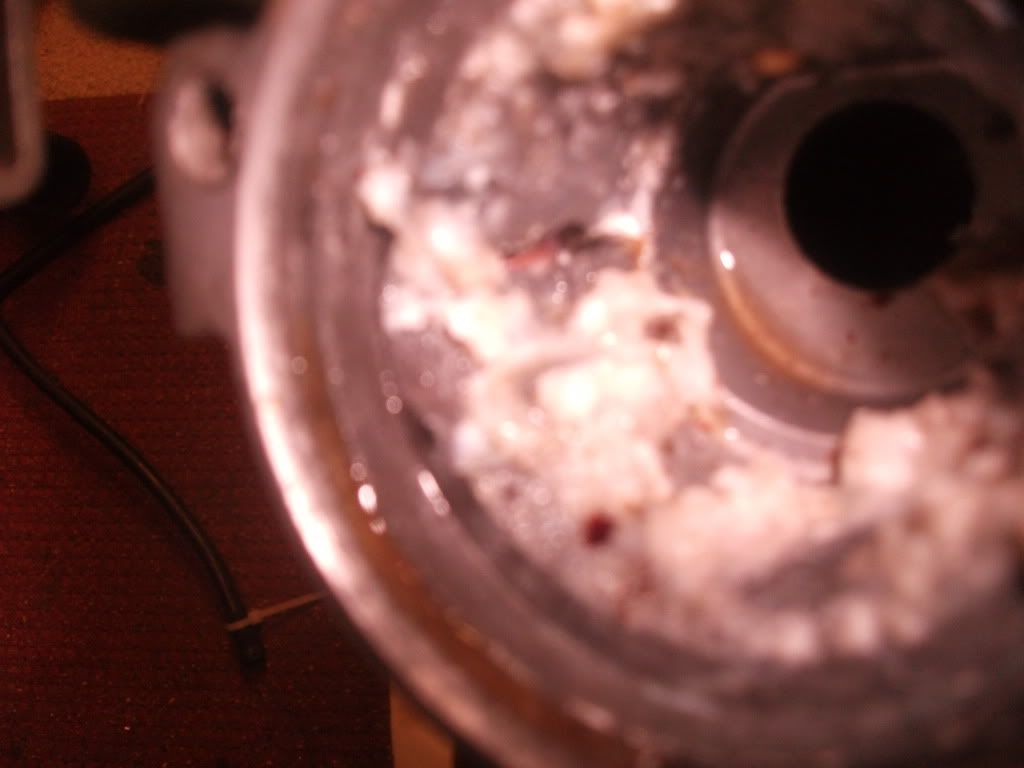

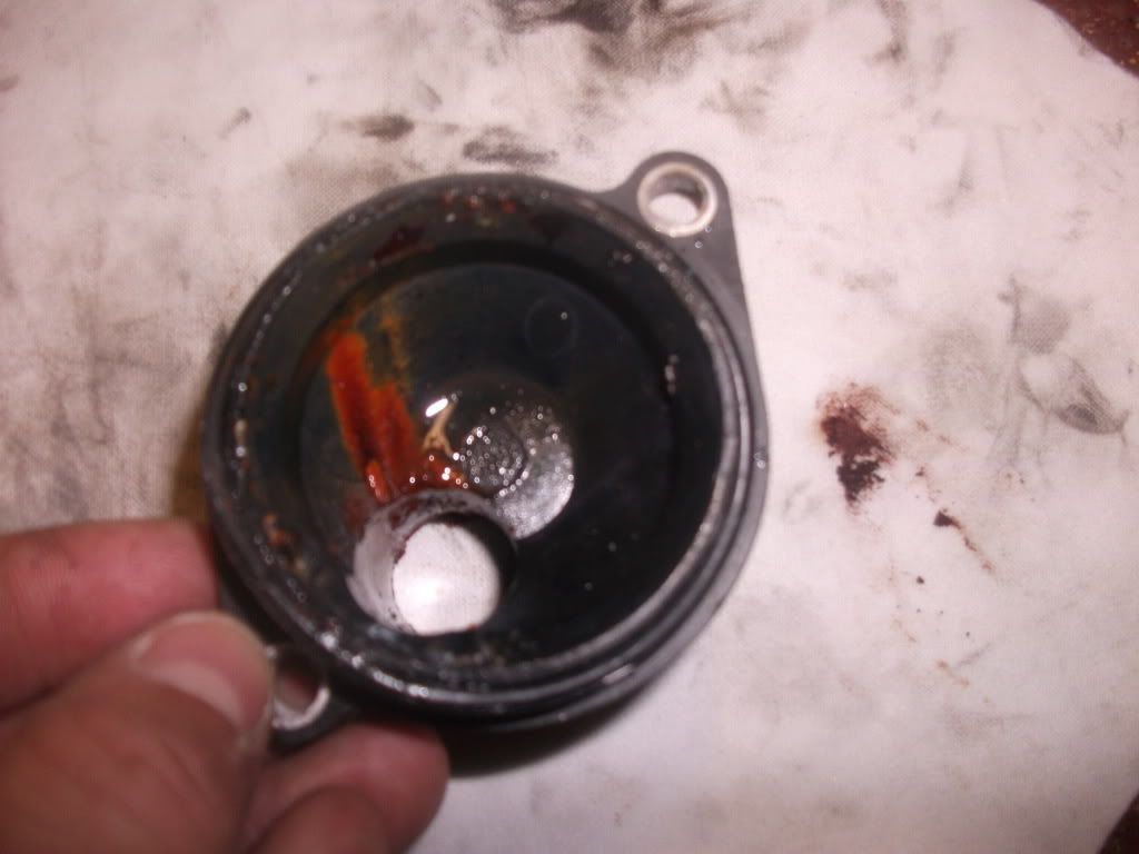

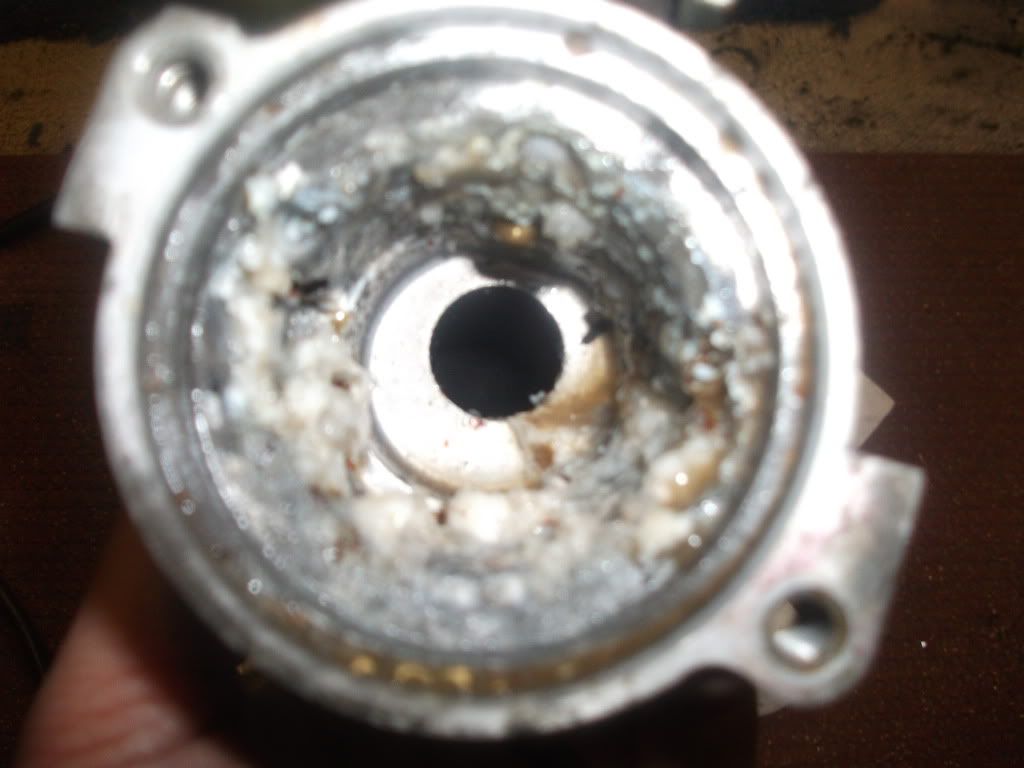

Well ive had a full on afternoon pulling the trx to bits...AGAIN!!!! :roll: Took the plugs out and turned the engine over and the water pump impeller turns nice and freely so im chuffed with that, also stripped the fcrs and they are spotless. On checking the plugs one only had a gap of 0.6mm which is weird but didnt think this would account for overheating.
So then decided to re-test the stat and strip the stat housing just out of interest and im glad and also pissed off that i did, inside looks very bad indeed. See the pics attached for more, sorry they are a bit dodgy...pants camera. They give the general image though that the hoses are full of dark brown/orange rusty sludge and also what feels like metal flakes!!!! :shock: Also loads of white lumps, some are mushy but some feel hard and crystalised....is this head gasket?? Should i also take the head off to inspect further or not??
Im concerned as the moron who did the mods to the exhaust had my bike for nearly 10 months, a long story so wont go into it. Anyway for 10 months it sat outside with no tank on in allsorts of weathers and was never started, my mate said that one of the overheating causes could have been that the water jacket could have corroded and broken down due to this long time of sitting still. Could this be the case or is it head gasket?? Cheers guys.

Pics have come out garbage but looked ok on the camera. Anyway this is the inside of the thermostat housing.

A bit clearer this time.

Thermostat itself.
Think you might have found the root of the over-heating at least... :D
But i am still a bit confused, so a couple of questions:
You wrote that you've had the stat out and testetd this? I understood it as this was part of the error hunt after the over-heating started, but now i am not sure? What has happened since you had the housing apart since last time (kms, time, repairs etc), and did you have the over-heating prior to this?
What kind of coolant has been in the bike? Tap water, distilled water, antifreeze/other additive?
Have you tried any of the radiator cleaner fluids one can get at petrol stations?
(I don't think a blown head gasket would cause this, unless the cloggy mass is created from a reaction between oilor a coolant additive and hot combustion gases)
Re: 2-1 exhaust
Post by Mincehead » Sun Oct 31, 2010 1:59 pm
You should go ahead and strip the top end of the motor, I suspect either head gasket or a cracked liner myself.
Ok, before that.......................................... A quick flush with a hosepipe, clean out the bikes coolant hoses and try it this way:
You want a 50% ethylene glycol and 50% deionised water coolant mix, no need for expensive ready mixed stuff, the 99 pence cheapo stuff will do at this point, then run the bike up to temperature, let it cool and take a look at the fluid by draining the block at the M6 (I think) drain bolt betweeen the header/front pipes if I remember correctly.
ANY white deposits evident or oily film and it`s a definate top end strip and inspect. :wink:

The TRX isn`t complex to work on, you shouldn`t have too many problems.Those chrystalline deposits may well be due to hydrocarbon deposits in the coolant from unburnt/partially burn fuel and oil.If you`re lucky it`ll be just a head gasket and if you`re unlucky a cracked cylinder liner.
