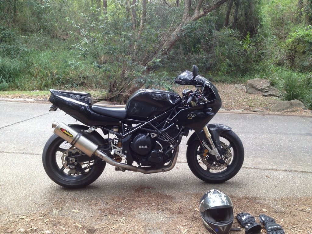

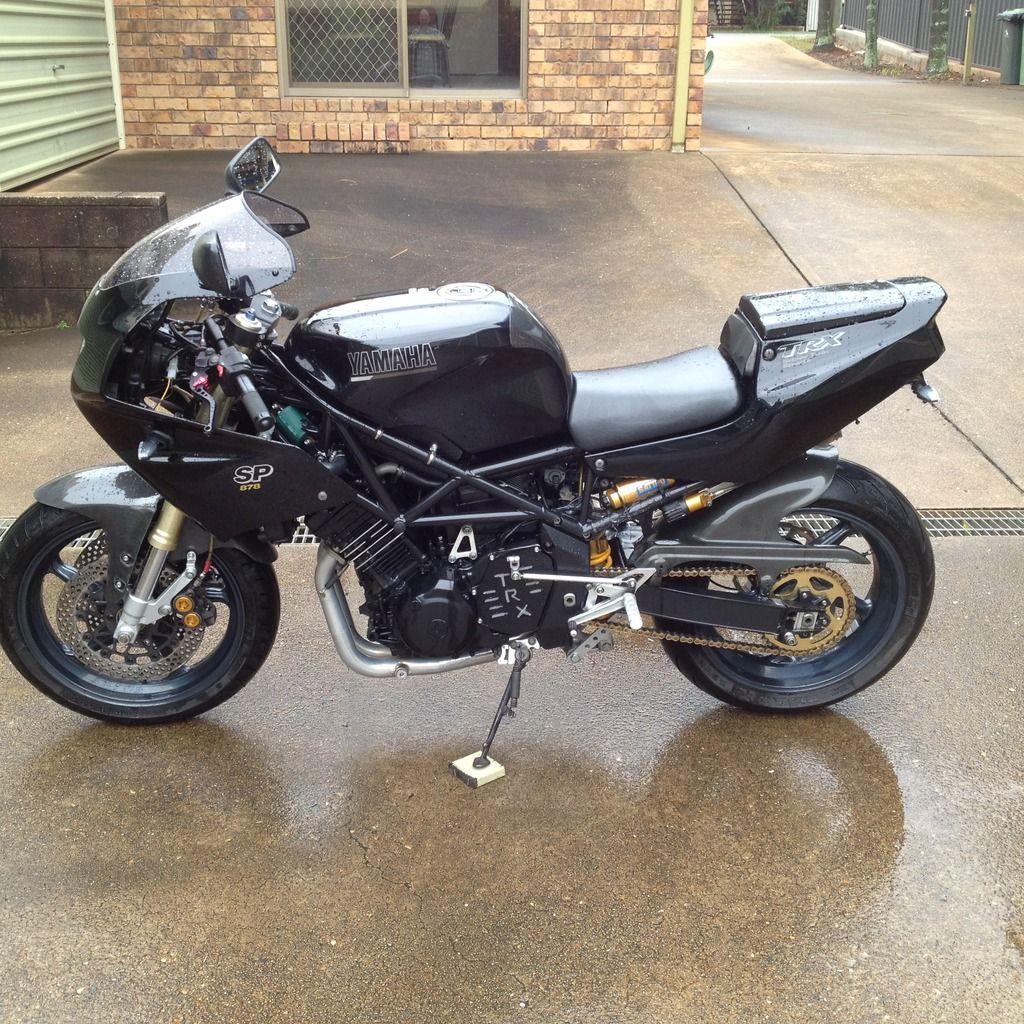

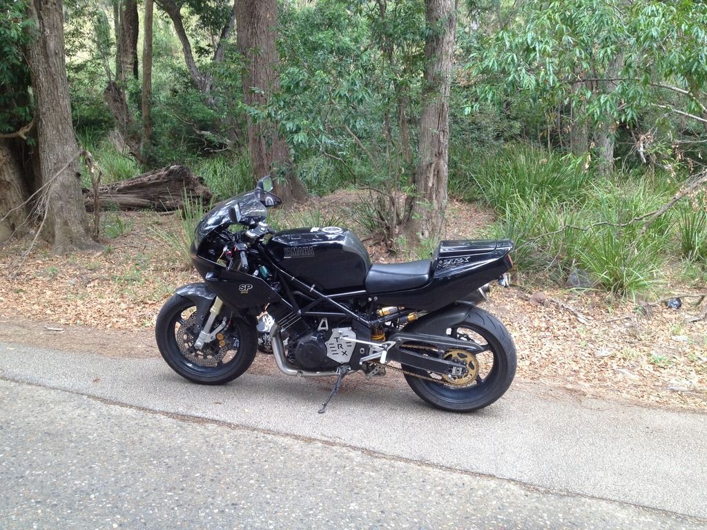

All running and just a quick hose down so now it's the finishing touches.
Still needs a little bit of trimming here and there with the YAMAHA stamped in on the clutch cover painted silver and gold caliper and wavey disc on the rear. 878sp Decals matching the tank /tail decal colours are being made up for the fairing, Akrapovic stickers on it's way.
Still a little dark on this side but I can highlight the TRX cut out of the sprocket cover or peel of the carbon coloured sticker and go back to alloy.

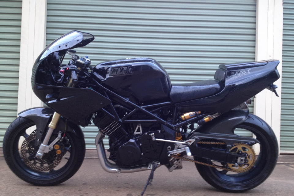

Post by cobbadiggabuddyblooo » Sat Jun 04, 2016 7:35 am
Just for you Dave and Dandy..
Back to the way it was..
