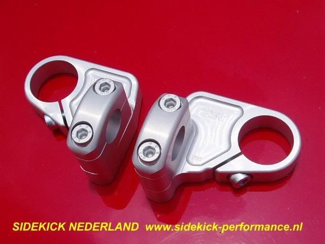

Post by CULater » Wed Sep 19, 2007 11:57 pm
There is a cheaper way, just use these ones 8)

CULater wrote:There is a cheaper way, just use these ones 8)
Ooh, I was looking for pictures of those online. Do you have any more info on them?
